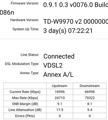

I have just rebooted the modem (again) to see if there were any changes. (See attached screenshot)

post your current router stats

Re: Sudden, random drop in connection speed... again
As promised:
