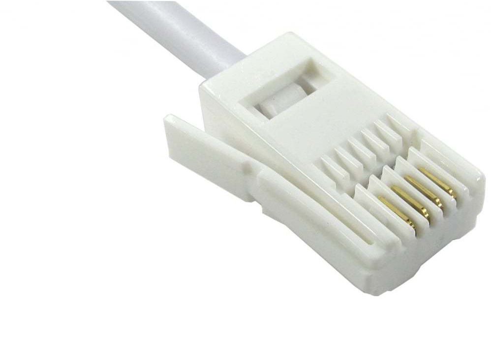

I did just notice that the test socket connection seems to be thicker that a standard telephone (filter) connector.  Is this normal?
345 Views
Message 15 of 15
Re: Sudden speed drop
The test socket takes the standard BT connector fitted to filters and telephone cables.BT filter connector.jpg
