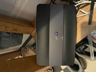

We have a BT Hub - I thought this was also a modem?

The BT hub is a modem/router, it doesn't have a modem only mode. You can use the C80 as a wireless access point by disabling DHCP on it, giving it an IP address outside of the DHCP range of the hub (192.168.1.10 for example) and connecting it to the hub LAN port to LAN port.
If you want to use it in full router mode it is more complicated.
