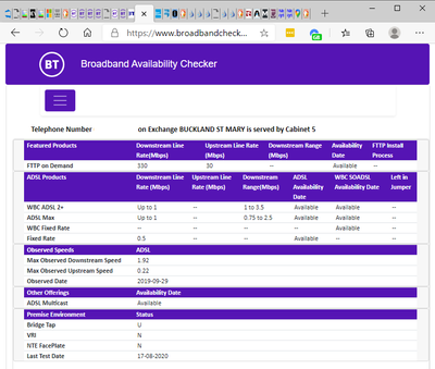

Tangentially, I notice that (some) others have posted Broadband Availability Checker results that specifically include references to the availability of VSDL. And mine doesn't.  Is that just an artefact, or are not all cabinets created equal?

Cab 5 has had FTTC available since September 2015 so you must be far to far from cab to get FTTC

I suspect you are just so far from cabinet 5 that VDSL won't reach you at all, hence no figures for VDSL. Fibre isn't  even available at many of the Buckland St Mary cabinets.
