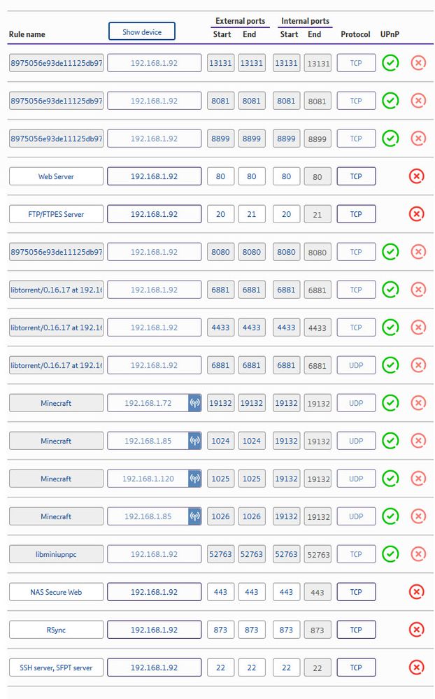

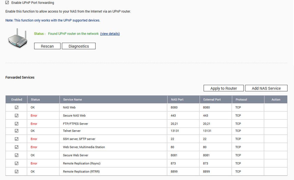

Hi, I've recently changed from Sky Broadband to BT Broadband. I was supplied with a Home Hub 6.0A. However, since changing providers my QNAP NAS (TS-853A) has stopped working correctly. It seems that the UPnP Port Forwarding is not working correctly. These ports are used for several of the QNAPs services, and should be set up automatically by UPnP, which is enabled in both the QNAP and HH6. However, only some of the ports are being set up. Several of them, do not appear as UPnP forwarded ports, even if i manually click the Apply to router button on my QNAP. I have manually set up the port forwarding for these ports in the HH6, but they still dont work and the related services on the QNAP do not work.

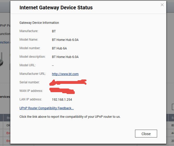

Here is the setup from my QNAP. As you can see, the QNAP can see the HH6 and obtain its details.
But the QNAP can not apply or use all the UPnP ports  which are forwarded.
I have manually set up the ports with "Error" on them in the HH6 port forwarding page. But they still do not appear to work.
For information, I have firmware SG4B1000B540, and UPnP and firewall are switched on. It makes no difference if i switch the firewall off in the HH6.

No need to change ISP, just get a proper router.
In the meantime, try disabling UPnP if you have manually set up port forwarding.
