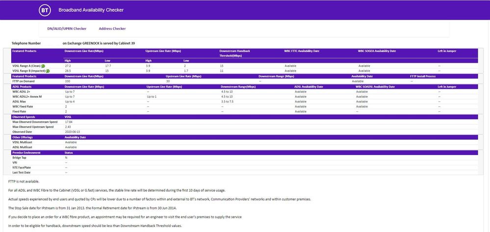

enter your phone number and post results  remember to delete number   https://www.broadbandchecker.btwholesale.com/#/ADSL

from your stats and dslchecker results your estimated range of connection speed is 27/17mb and from your hub stats you have an 18mb connection so at bottom of expected range.  your connection has been stable for 4 days and looks ok with noise margin normal at 6db and attainable at 21mb slightly higher than actual

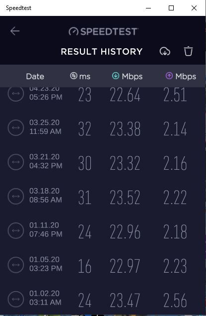

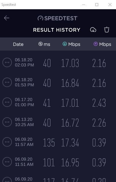

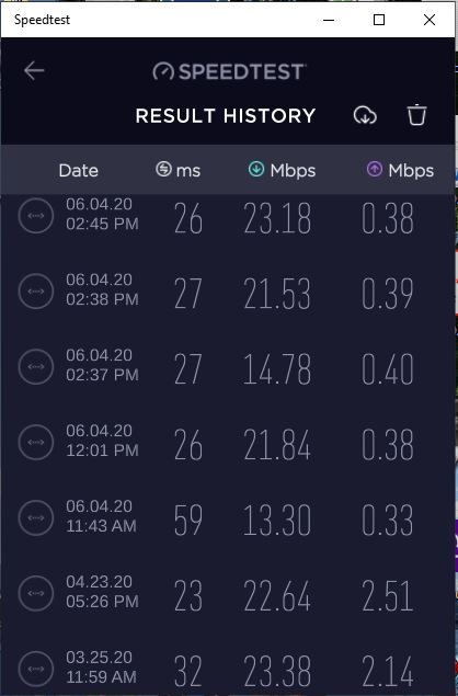

Speeds TodaySpeeds TodaySpeeds at start of problemSpeeds at start of problemSpeeds prior to problemSpeeds prior to problem
