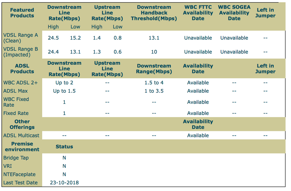

Can you post the result of your phone number (remember to blank out before posting), from here: http://dslchecker.bt.com
1,378 Views
Message 3 of 9
Re: Unstable Fibre Broadband
1,376 Views
Message 4 of 9
Your sync speed is considerably lower than the estimate. Can you confirm whether the Hub is connected to the test socket?
