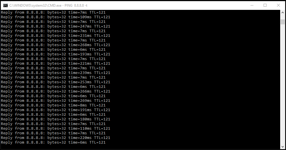

I appear to be  expierncing high latency spikes when only a fraction of my total bandwidth is being used.
This makes certain activites such as online gaming virtually impossible and I'm stumped as I have never had this issue at any other address or ISP.

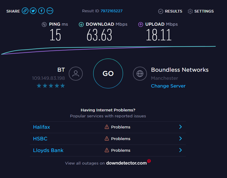

My speedtest shows 60Mbps+ download, I feel that should be enough for 2 online activies without massive jumps of latency? I did upgrade my package to the "Superfast Fibre Plus" before Christmas in hope that this would resolve the problem but unfortunately it hasn't.
SpeedtestSpeedtest
 Pings to google DNSPings to google DNS
