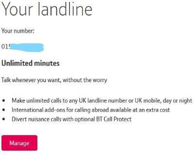

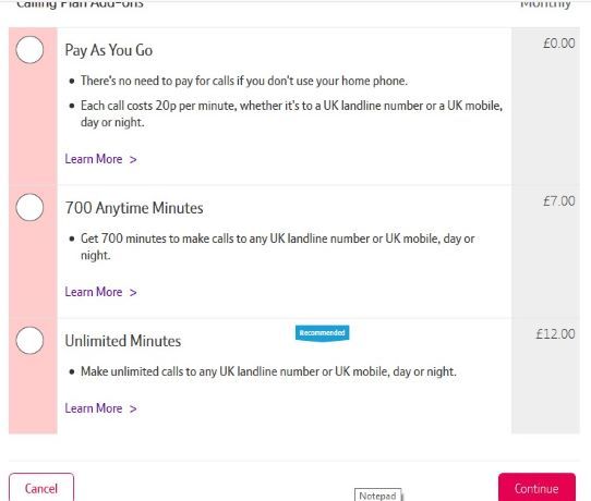

1. When I click to effect this upgrade I am taken to a page that insists on a landline "Add-on" that destroys my current deal of free anytime calls to landlines. I assume that there is no way of overriding this. £7 or £12 per month is far too much for the small usage involved, and £0 means paying 20p/min for calls that are currently free.

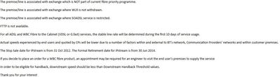

Thank you. FTTP is not available

Re: Upgrade to Fibre 250 Halo 1: 2 questions

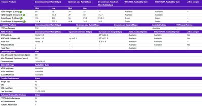

the rest of the report:
so from dslchecker results you are getting G.FAST which needs engineer to fit new master socket faceplate and you need a new SH2 capable for G.FAST connection.  it will use same connection wiring as existing FTTC -fibre to cab and copper to your homne
