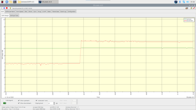

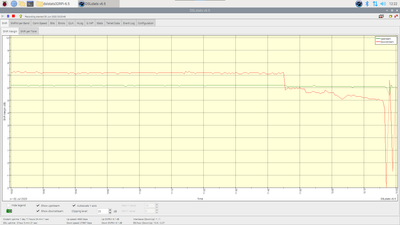

Hi, I'm noticing a pattern with my line. For whatever reason, the SNR would slowly drop to around 4.0db and then give it a few hours and it would disconnect.
DSLStats graph showing the disconnection which would happen around midnight.
Before this, I noticed the line spike downwards from time to time as seen here:
Tonight I've noticed a spike and the line disconnecting as well. This was the night after the first screenshot:

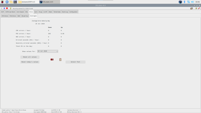

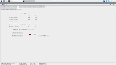

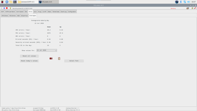

Error averages from 18/07/2020 to 25/07/2020
ThinkPadUser_6-1595720210213.pngThinkPadUser_7-1595720227611.pngThinkPadUser_8-1595720235904.png
