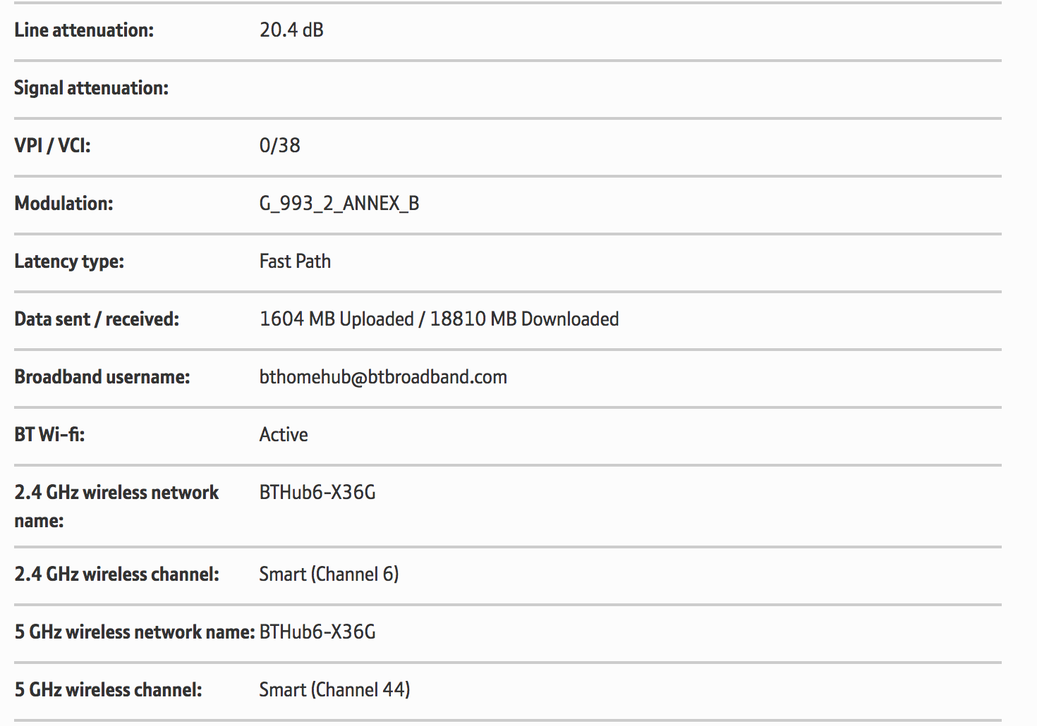

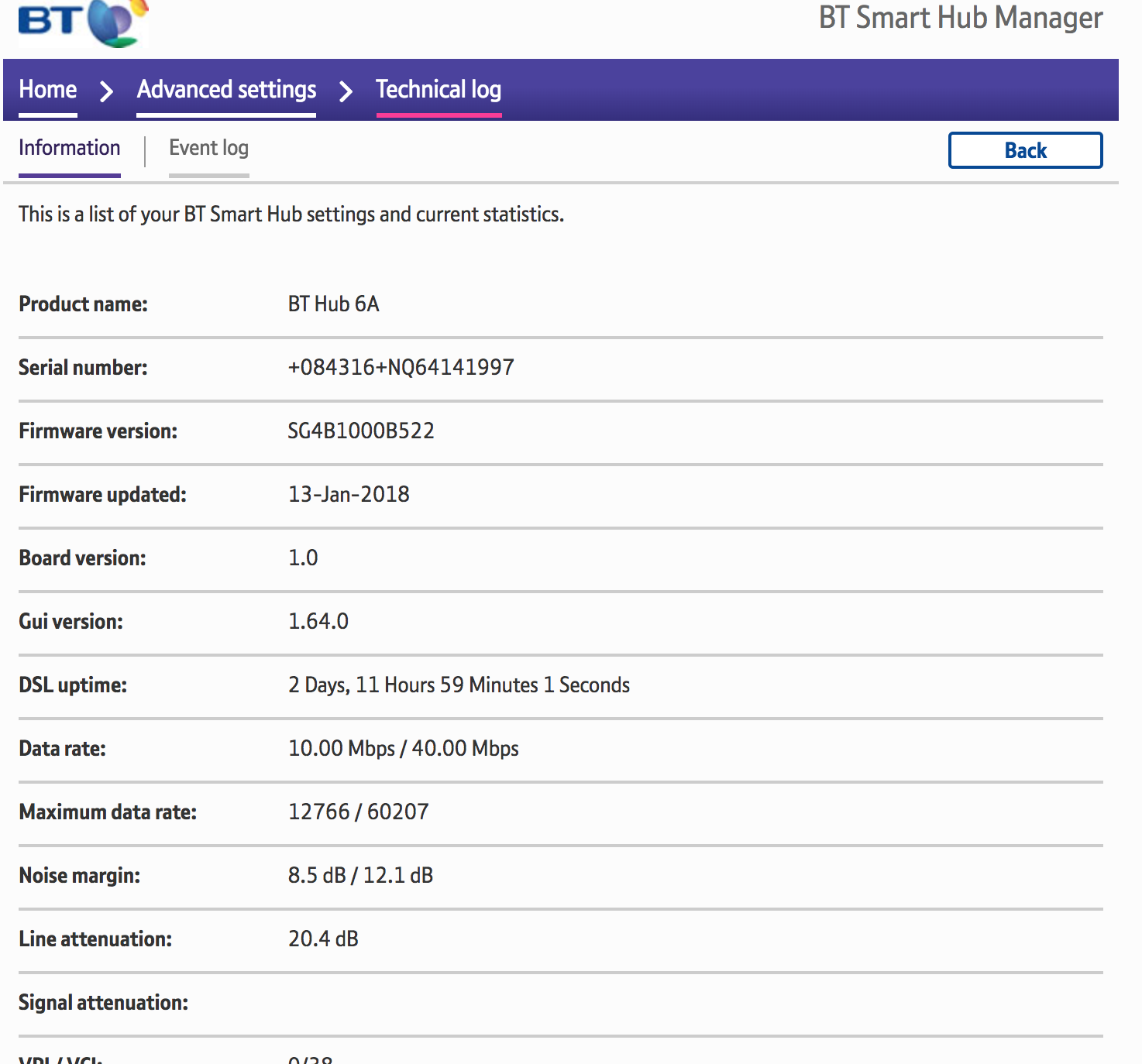

Screen Shot 2018-01-16 at 13.53.26.pngScreen Shot 2018-01-16 at 13.54.30.pngScreen Shot 2018-01-16 at 13.54.45.png

Try connecting to the test socket with a filter. Whilst there conduct a quiet line test 17070 option 2. Best with corded phone. Any noise report a line fault on 151, do not mention broadband.
Then check any extentions you have have no dial tone.
Finally repost stats.

Re: WHAT HAS HAPPENED TO MY FIBRE BROADBAND SPEED??
Go to solution
With a nice round number data rate of 10/40 it looks like you are on the "old" Infinity 1 profile of 10/40. This might have happened accidentally when your Broadband package changed.

Have you recontracted at all recently , and inadvertently asked for Infinity 1 as that is now marketed as a 40/10 product and has a 30GB monthly usage allowance.
You should have asked for the unlimited infinity package with up to 52Mb( which is the old infinity 1 package rebranded). This won't have been your fault but the speeds should have been made clear to you.
