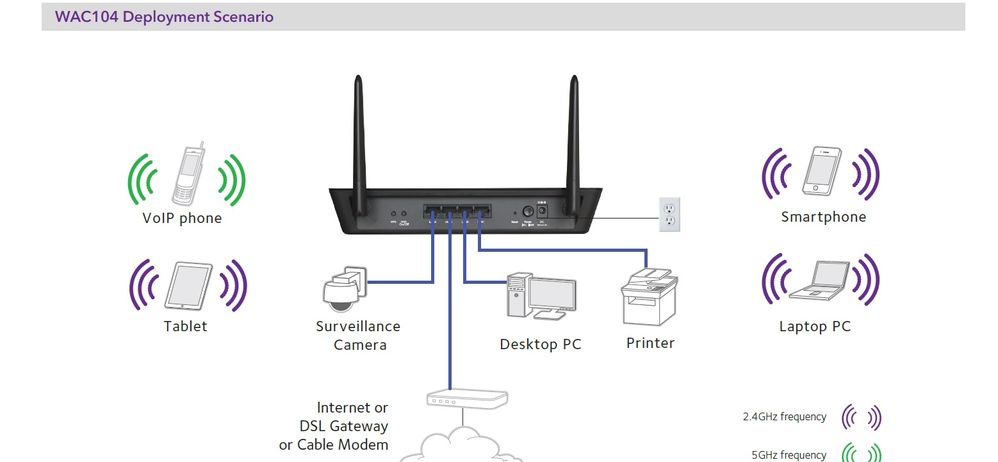

Whilst not a particular fan of Netgear, this will fill the bill.
Netgear Wireless Access Point (WAC124) | Dual Band WiFi AC2000 | 4 x Gigabit Ethernet Ports + 1 x USB Port
on offer at £55 at Amazon (forum rules forbid posting a link)
or the WAC 104 at £43
4,167 Views
Message 6 of 10
Re: Which router do I need to buy to connect to Smart Hub 2 from Summer House
The WAC 104 (Netgear Wireless Access Point WAC104 | Dual Band WiFi AC1200) does not appear to have the yellow "Internet" port on the back like the WAC124. I guess this means it is not suitable for the situation I described as there is nowhere to plug in the ethernet cable from the Smart Hub 2...correct?
4,162 Views
Message 7 of 10
Incorrect. The WAC124 can also be configured as a router, hence the Internet (WAN) port. If you just need a WAP with a 4 port switch, you connect one of the HUB's LAN ports to one of the WAP's LAN ports.
