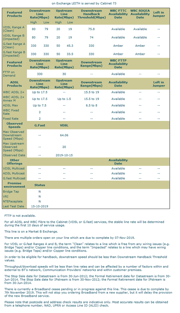

enter your phone number and post results  remember delete number but leave exchange and cab   this will show what is available to you
https://www.dslchecker.bt.com/adsl/adslchecker.welcome

as you can see your option is not FTTP but G.Fast - G.fast uses your current FTTC connection - fibre to cab and copper to home  phone 08005874787 if you want to try an order or find out more
