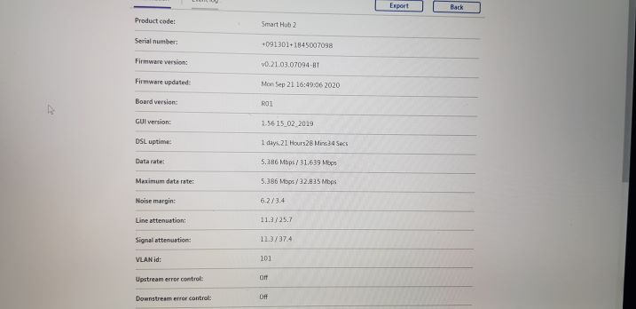

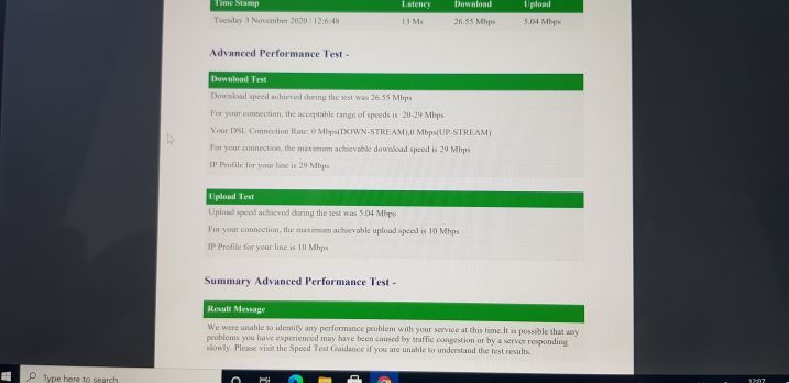

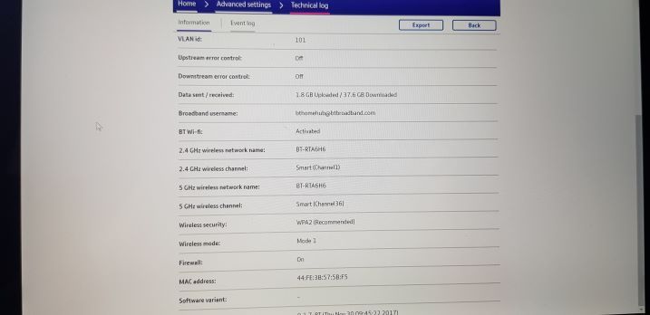

Hi did the line test as suggested all i could hear was a low frequency sound best described as shhhhhhhhhhhhhh that was constant and fixed and i used a corded phone.In the process of uploading tracert and BT wholesale test report and hub stats.

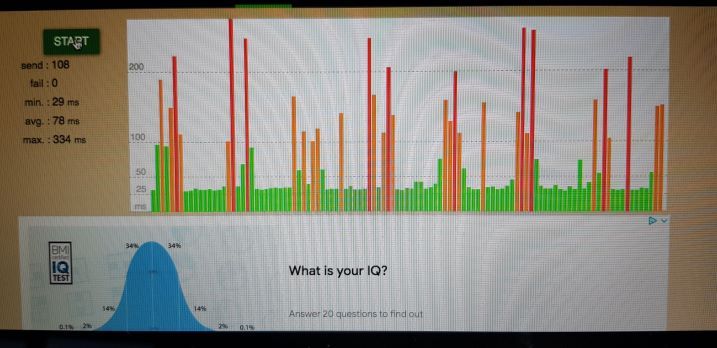

Look at this what is going on?????
unusableunusable
