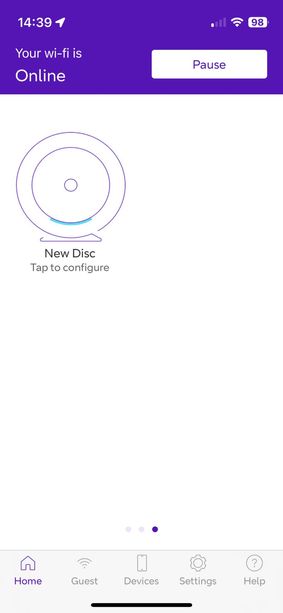

Yes and no.....so after getting a 9th disc for the garden (why not) from Ebay, again for barely 20 quid....I tried to add it to my network, it took a good few factory resets using the pin on the rear but eventually it joined and it works, and you can connect to it and see devices connect to it, you can turn its lights on or off and do everything really, what you cant do is name it...well actually you can but let me explain. It turns up there on a new 3rd page in the app as 'New Disc', you can name it but from this page view it will not display its name, but the naming process is stored by the disc its self. If you switch off the disk it disappears from the app all together, it doesnt show disconnected, its gone, power the disc back on it comes back and functions fine but it doesnt display its name. If you visit the LED brightness menu it shows its name in there, also if you look at devices and check what a given device is connected to it will show its name correctly in there.

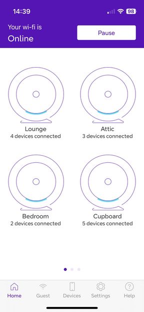

Page 1:

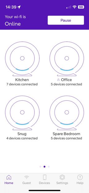

Page 2:
Page 3:

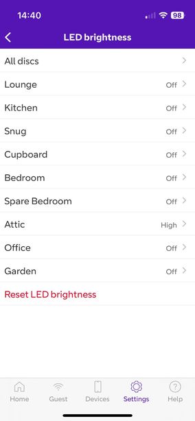

In LED brightness all the names are there

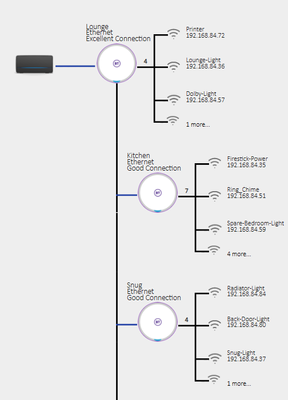

8 Discs: (Screengrab only shows 3 but the other 5 are below)

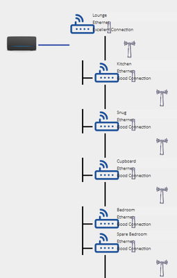

9 Discs:  (The screengrab doesnt show all the discs again, the GUI does however but the views all wrecked)
Every other view in the web gui works though and you can name the disc in there, it shows up with its correct name along with any devices connected to it.
