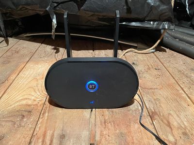

Hi everyone,
Just a quick update.  My antennas arrived and I've attached them, very easy to do.
I've gone from -109dBm signal strength to -96dBM.  The 4G signal is now sitting comfortably at 2 out of 3 bars, which is what I was hoping for.
I would definitely recommend doing the same if you're like me and you're just on the edge of having an acceptable 4G connection.
To get these ones, I just searched Amazon for '4G sma antenna indoor' and chose cheap ones (£8.99) that I thought looked nice and would match the Hybrid Connect.  The deeper you go into the subject, there appear to be really powerful antennas available, but that seemed overkill in my case.
Thanks BT for the Hybrid Connect by the way - real peace of mind now!

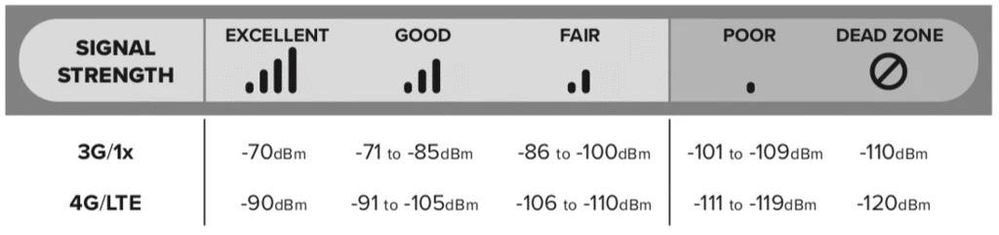

Also, I'm not sure if this helps anyone else, but I found this little chart whilst I was doing my research:
I don't know how accurate it is, but it definitely seemed to match my experience:
My 4G signal was -109dB at first (which puts it almost in the poor category).  With the antennas it has since jumped to -96dB (which now puts it firmly in the good category).
I assume the Hybrid Connect would need to be -90dB or better before it started showing 3 out of 3 bars signal.
