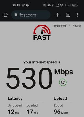

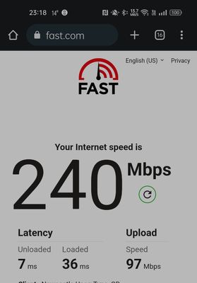

Re: Is it worth upgrading my full fibre 900 from Whole Home Wifi to Whole Home WiFi Premium (Wifi 6)
I shall not agree with "capped" part when talking about Whole Home disks (black ones)...
See screenshot with lower speed, it's my Oppo phone connected via Black disk, which ks wirelessly connected to SH2 (if connected to hard wired - another - disk, speed will be up to 350 Mbps)...
However, screenshot with much better speed it's from very same spot, same phone, but connected to my TP-Link AX router on channel 124 (a.k.a third band)...
