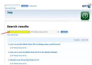

There are more FAQs online on bt.com. Use the search box, as per screenshot below:
If the above topics and FAQs don't help with your issue, try searching this forum to see if someone else has already posted a similar question, or create a new post.
