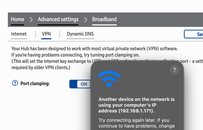

Since we have swapped to the new contract we have had endless connectivity issues - the ethernet and wifi speeds are fine but the connection randomly drops in both limiting ability to do any work. My work laptop wont connect at all. Husbands work laptop will connect via ethernet only but again repeatedly dropping. My personal apple mac laptop tells me repeatedly someone else on network is using my IP address. Our iphones only remain connected to wifi if switch off data as presumably they are considering the connection weak and keep trying to revert to my (non existant) data.

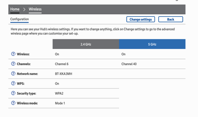

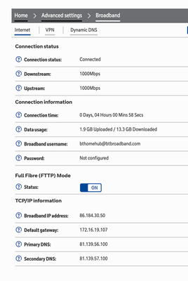

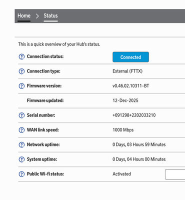

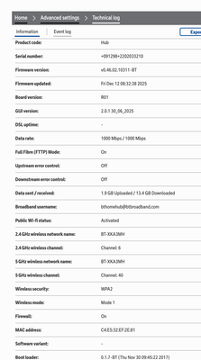

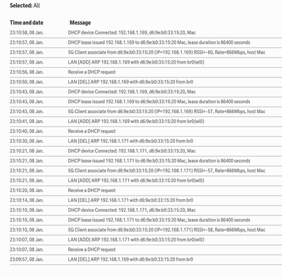

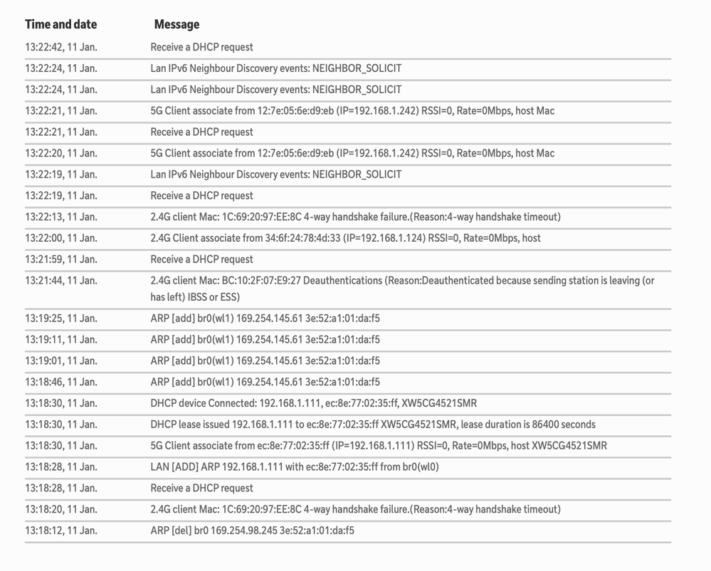

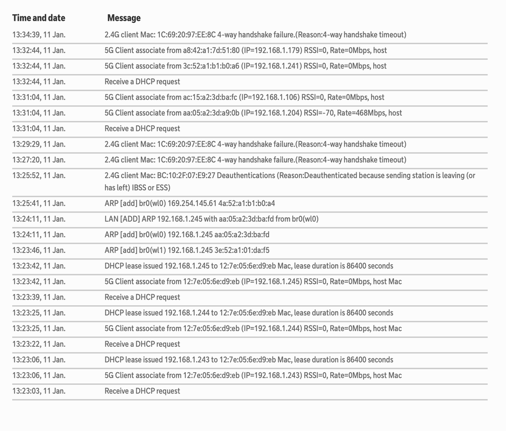

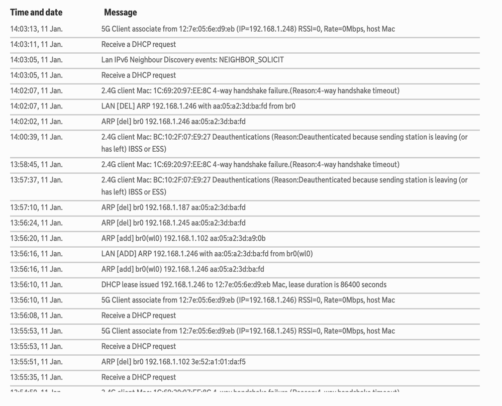

The problem appears to be with the Hub's DHCP server.
Are you using a VPN, if so try disabling it.
Also, turn off MAC randomisation on your devices and then factory reset the hub via the button rather than via the hub manager.

The drop outs have improved since openreach and exec complaints person but are still happening and both work laptops are not connecting reliably or in my case at all. My Apple Mac also repeatedly tells me that another device is using my IP address. The exec complaints person couldn’t explain this at all.

There just seemed to be a lot of DHCP requests in the logs, but looking closer they are probably as a result of the device disconnecting. Is it just WiFi connected devices that are affected or Ethernet connected devices also?
The problem appears to be local rather than a line problem.
The comment from BT that disabling MAC randomisation is detrimental to the hub is totally unbelievable. The opposite is true as  the hub runs out of internal connections.
You could try eliminating the hub by making a direct PPPoE connection to the ONT from your laptop.

By local I mean that the problem is within your home network, not a line problem.
The DHCP requests wouldn't occur with a line problem as your home network would still be operating.

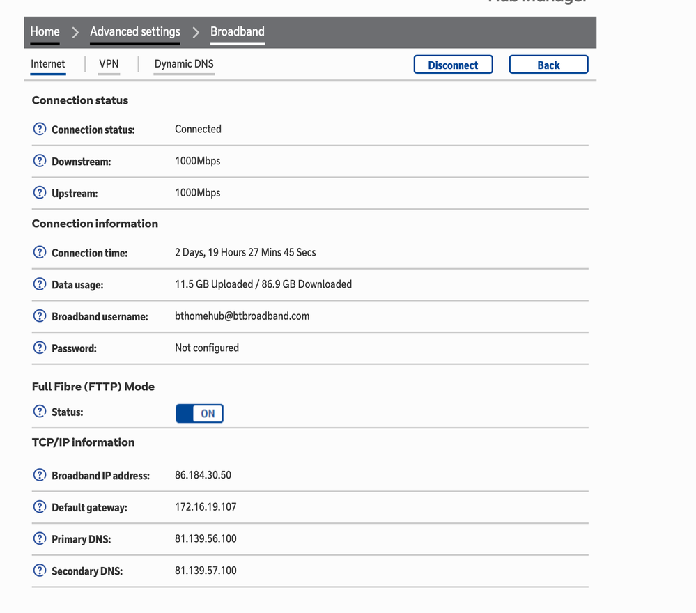

I notice the hub uptime in your screenshot is only 4 hours, is that due to you resetting it?

Yeah the 4 hours at that time because of a recent factory reset.
Screenshot 2026-01-11 at 14.28.48.pngScreenshot 2026-01-11 at 14.28.58.pngScreenshot 2026-01-11 at 14.29.09.pngScreenshot 2026-01-11 at 14.29.18.pngScreenshot 2026-01-11 at 14.29.25.png
