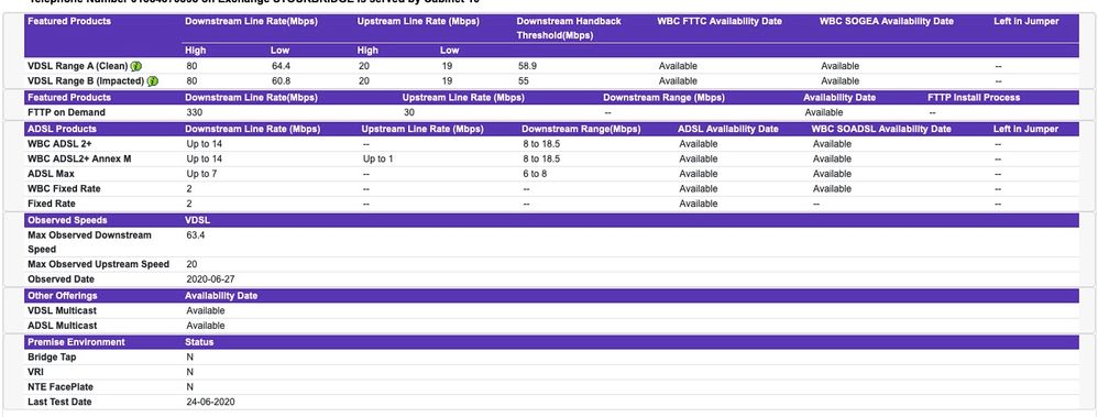

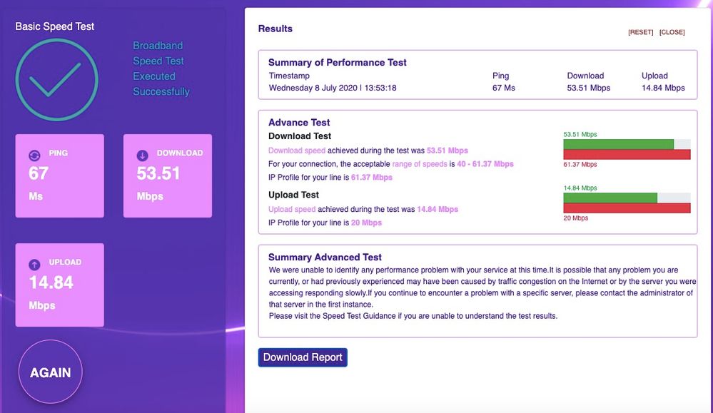

Hey there,
Hoping somebody can help me out with a DLM Reset if possible. Speeds have gradually been dropping since September last year and had some instability last few months leading to drop outs, pings have climbed but has not recovered.
Router stats and info from BTW included.

Until the instability is fixed there is absolutely no point in a DLM reset as DLM will just lower your speed again.

I've suspected its been a hardware issue used the Openreach ECI VDSL router had recently changed over to the zyxel vmg8924-b10a which has been better but DLM still doing its tricks. Previously had 79/20 out of it which is a real shame about the drop.

Just wanted too post an update. Issue has been caused by a bridge tap which was not noticed by the engineer that came to install the connection first time around.
Bridge Tap has been removed so a DLM reset would now be advantageous
