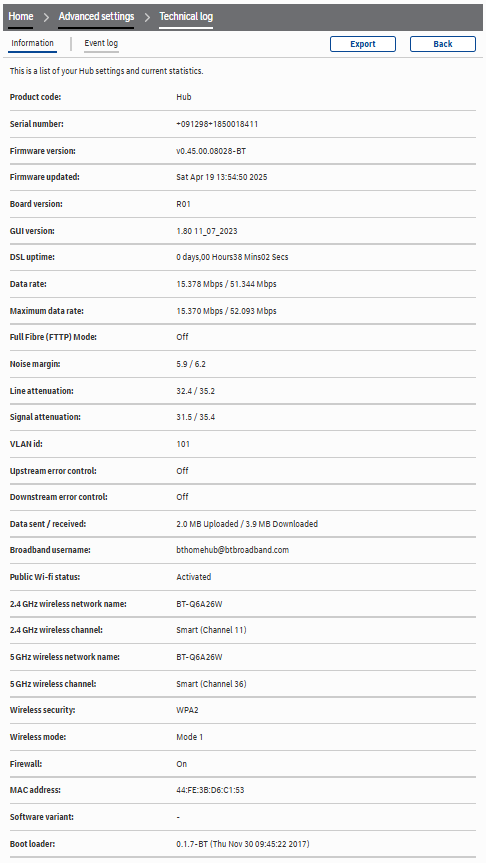

I don't think the previous upload was readable. Try this!

You're still at 6dB SNRM, once your line is stable for a few days DLM will reduce margin to 3dB to give you an increase. Doubt it will increase to 70 but you might get 60.

Ahh, thanks. I did wonder if the line would "settle" after a bit, but both BT and Openreach technicians dismissed the possibility when I suggested it.

Noise margin should drop in 1dB steps down to 3dB over a few days.
