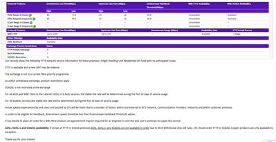

can you enter your address and post results including all the notes
this will short what connection openreach expect at your home

Here are the results from that site. I've been told that a connection is possible, its just the finer details I was trying to confirm up front
