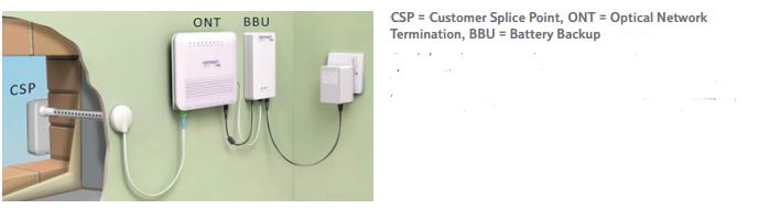

Also, for 1 stage install does this mean that there will be no CSP? Searching the forums I was using this for reference
https://community.bt.com/t5/image/serverpage/image-id/29435i4A834EA8D8BFACDC/image-size/original?v=v...

Once the external cable is terminated on a CSP and an ‘internal’ optical cable is ran to the location of the ONT , again you shouldn’t expect the tech to run that cable through various rooms inside the property there will be limits ( not least the length of the internal Ezibend optical cable ) ….once the ONT is fitted which needs to be close to a power outlet , if you don’t want the router sited close to that position you can always provide your own ‘connection’ from the ONT to the router using your own Ethernet cable , or CAT wiring you have had installed or power line type connectors.
Single stage provision just means they don’t have to come along in advance of the install date to check the underground duct to the property is serviceable, overhead provision will generally by single stage , underground, generally 2 stage.
