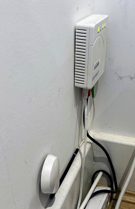

Shoddy work indeed.

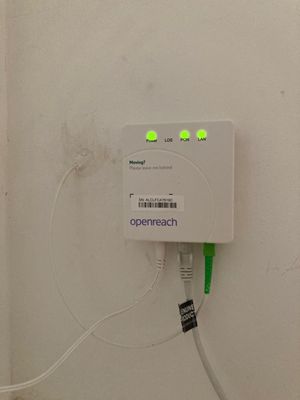

A quick update - installation went fine. Tellingly the engineer put the fibre optic straight through the wall without the liner or internal cover so the cable runs straight into ONT.  I provided the hook to fly the cable outside from telegraph pole to the house (OR approved) - he said he’d used his last one on the previous job 😳. Anyway, I got the routing I wanted and he was attentive to my requests. Here’s the internal arrangement- a bit of filler where optical cable enters the house and I’ll match paint the filler to cover it up.

Openreach turned up for the 4th attempt at FTTP. They were very good. Used the existing hole in the external brickwork for the fibre cable, with no plastic sheath so didn’t have to enlarge the hole to accommodate it, and didn’t fit one of those neat internal point-of-exit caps with its 15mm housing in the wall - the cable just emerges as in the pic above, and I’ve used a bit of filler likewise. I’m not particularly bothered, as the exit point is now concealed - boxed in along with the cable for the spur to the new double socket.
