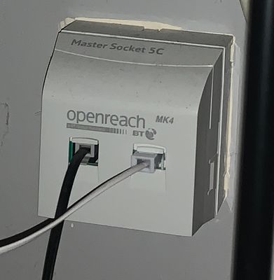

Hi, I got this text from BT...
'Hi, Full Fibre broadband is now available in your area, and you can upgrade today. Enjoy game-changing speeds, faster than our standard fibre, direct to your door. Get speed you can rely on. Even at the busiest times. Terms apply.'
I am currently on Fibre 1 and get an average 36Mb. I'd like to go for the upgrade, but I'd like to know how the setup process works for this.
I have included a photo of my BT socket below.
We have some furniture close to the socket so I mainly want to know if an engineer needs easy access to this so I can be sure to make ample room for them to work. I read something about an ONT, I don’t know what that is. Is this another box I’d need plugged in alongside my existing Smart Hub 2?

Assuming you can get FTTP , if your service is overhead from a telegraph pole , then a new fibre dropwire is erected from the pole to your house, it is terminated on a CSP and an internal optical cable ran to the location of the ONT , this doesn’t have to be where the current master socket is, but  it has to be be near mains power ,  within reason, you can ask the installer to put the ONT where is best for you , underground is similar but the cable brought to the house wall underground.
As indicated , you need to check , as you could have a situation where neighbours have different  survey results, one may say no anticipated issues , another may need a pre install visit ( KCI2 ) to ascertain what’s needed to provide service…
Just seen your post, looks like overhead with no anticipated issues ,

Thanks for info everyone. The BT master socket I posted a photo of, what happens with that, does it stay or go? I was thinking this ONT box thing would just replace the old master socket.
We do actually have some other wall sockets in all the rooms with what appears to be ethernet and TV aerial sockets. I don't know if it's possible or worth exploring doing anything with these for the new Full Fibre setup? I can confirm the TV aerial sockets only work in the main living room, and not in any of the other rooms - perhaps this indicates the ethernets won't be setup properly either.  Would be nice if that could be hooked up and then all the rooms can have access to wired connection at fast speeds. Or is that likely to be a hassle?

The fibre cable terminates in the ONT which is the optical modem. The ONT then connects to your hub via an Ethernet cable. Any further cabling to provide Ethernet connection to your devices from the hub is entirely your responsibility.
If you wish the hub to be sited remotely from the ONT, it will be up to you to provide the necessary Ethernet cabling.
With Digital Voice, your master socket and any extension sockets are effectively redundant although Openreach will leave everything in situ rather than remove it.
The ONT doesn't have to be in the same location as your current master socket as it is a totally separate service.

If the master socket is redundant, for a tidier setup I presume it would be common for them to run the new optical cable along the same path, remove the master socket and put this new ONT box in its place. Is that how it typically works when upgrading?
