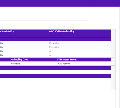

This is the result of the check
3,735 Views
Message 4 of 13
Re: Help with new installation
Here is the rest of the result info on the right
3,729 Views
Message 5 of 13
Ok, so as I thought, it looks like a Fibre Product was ordered, given that FTTP is available to order, it was ordered I assume and then the engineer wasnt prepared to do the work, for whatever reason. Usually it involves removing the copper and replacing with fibre. As FTTP is available I doubt its possible to order a copper service on the ISP's sites.
So you are not in a helpful spot....
This is one for @iniltous if he is free, his insights are beyond space and time on all things installation related.
EE900 | Nokia ONT | Ubiquiti ER-X | EETV Box Pro (IP Mode) | Unifi CK2 | 6x Unifi U6+ | 4x Unifi SAK Ultra
3,726 Views
Message 6 of 13
The address has FTTP ( full fibre ) available but this MDU ( multiple dwelling unit ) shows built to the curtilage, so basically the fibre is at the boundary of the MDU and footpath, this can cause issues depending on the relationship of the flat occupant and freeholder etc….if for example to get to a flat on the first floor cabling would  have to attach to the ground floor after crossing the freeholders property ( garden , paths or through stairwells , building risers etc ) the person ordering service obviously cannot grant permission for any of that … these will show as 2 stage installation ( KCI2 assure ) as shown in the DSL checker return , so that any issues ( permits, wayleave, agreement from the building owner etc ) can be obtained….the existing copper cables now that FTTP is available are effectively redundant, obviously there are many variations on MDU , from converted houses , to purpose build apartments complexes , so the survey notes are vague , it’s when OR contact the freeholder etc. that a way to service the property is explored.

@ClaireG85 he was already replying when I typed my last update.....
Given that it is marked as KCI2 assure Openreach should be aware of what is required to install, so @iniltous should they be turning this one down?
