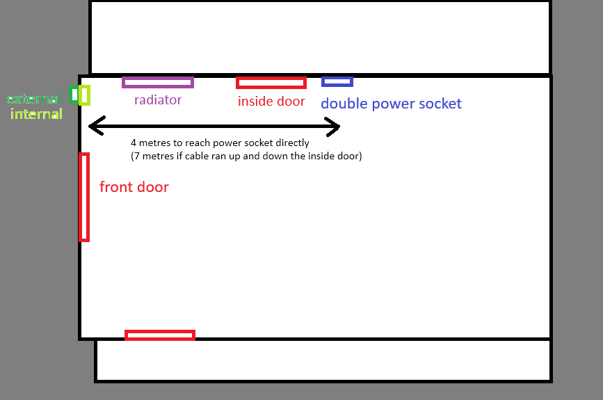

Hi, I'm getting fibre installed and I have a question about the length of the internal cable and how close things need to be. I have included a picture to make the visual easier.
So: I would like to have the external box placed besiden my front door, on the front wall of my house (9 inch thick wall). Then I would like the internal box on the opposite side of this front wall. Then I would like the cabling run either 7 metres or 4 metres (depending on whether the box is installed at ground level or not, as if it is then the cable will be need to ran up and down the inside door) to reach the near double power socket.
Is this a viable set-up? I don't know how long the internal cable can be ran. Is having it run for 7 metres total around a door viable? Is having the nearest power socket be 7 metres inside the house okay?
Thanks for your help.

Your question doesn't make sense. The 'internal box' as you call it is the ONT which requires power. Not sure what cable you are talking about.

if the 'internal box' the ONT is placed as in diagram then you are going to have to run a power cable from the ONT to power outlet  the cable that comes with ONT will not reach
you are going to need to discuss siting of ONT with installer

I only placed the ONT there because I thought I read that the External and Internal box will be placed on the opposite side of the same wall.
If that is not the case, then the external box can remain where it is, and the cable will be run to the power socket and ONT which will now be beside each other. (if you look at the picture, just move the internal box to now be beside the power socket)
Does that set-up sound viable?

Openreach use what’s called an Inside-Out Cable. They come in pre cut lengths of 5, 10, 20, 30 and 50m.
The outer sheathing can be striped back where it goes from the outside to inside.
When I did FTTP Installs there were two Installs Types, Basic and Premium.
On a Basic the Engineer can run up to 10m Internally and on a Premium 50m.
That was a few years ago though, rules may have changed since.

@boonjj  If you’re like me I try to think about options before being put on the spot when the installer arrives. Trouble is, unless you’re an installer you don’t really know what’s possible. All you have to go on is that the internal ONT  has to be powered, connected by fibre to external box and connected with an Ethernet cable to the hub. It has a I think about a 1m power lead. The cable from the External box (Customer Service - or is it Splicing? Point) CSP to the ONT is a a thin fibre cable. Which - from others here comes in various lengths. But before the installer arrives you don’t really know how far they would be prepared to run it. Anyway,  something to think about - fibre cable doesn’t like sharp bands. So going round a door frame with sharp 90 degree bends, like you do with copper, is not possible. The minimum bend radius from what I gathered on this forum is that of a £2 coin. So wouldn’t look very neat around a door.
Of course the BT hub has to be connected to  the ONT with an Ethernet cable. Now being copper you can be far more flexible how and where the cable runs. And in practice can be any length from ONT to hub ( well in theory upto 100m but we’re talking a house situation here). The downside to the Ethernet is that the Installer is unlikely to play ball and you’d have to provide and route the cable yourself. Saying that, at least you could put a temporary cable in place ( a long Ethernet patch lead or whatever) just so the install gets done. And then get someone in to make a neater more permanent job?

@boonjj  Worth bearing in mind that the ONT doesn’t have to be plugged directly into the power socket, but can run off a power extension block., which might be easier to route the cable alongside the bottom sill of the door, and if covered, would be more resilient than having the internal ONT cable routed that way
