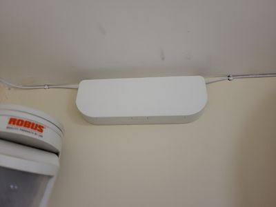

Hi,
I've only ever been able to get FTTC 80MB internet to my flat.
Today I noticed this box above my front door and I think it must be for FTTP? (Nobody has notified us apartment apartment owners)

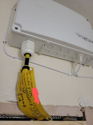

 Following the cable down, it leads to this bigger box near the ground floor service cupboard, with the yellow tag:
However when I put my address into the checker at https://www.openreach.com/fibre-checker it says it is not available and they do not have any plans to build?
So am I mistaken and this could be for another purpose?
Thanks in advance

Re: Is this for BT / Openreach FTTP
Go to solution
That is Openreach FTTP (MDU) , so if it’s ‘live’ then ordinarily you could order,  so presumably the equipment is fitted but not ‘lit up’ or there are discrepancies with the addresses within the MDU
https://www.broadbandchecker.btwholesale.com/#/ADSL/AddressHome
https://www.openreach.com/forms/fibre-broadband-availability---customer-form
enter your address at the first URL , does it show WBC FTTP as available ,
If it doesn’t fill in the formwize on the second URL ,
If the equipment has just been fitted you may be a little premature expecting availability so soon after the equipment is fitted ,
