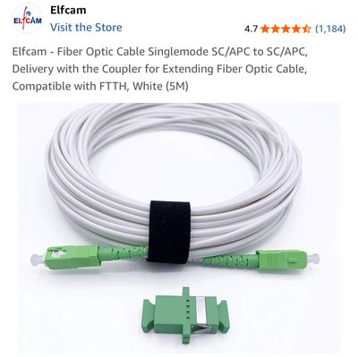

You could leave the incoming fibre where it is and buy an extender like this and move it yourself.

Or better still, leave the ONT where it is, and run an ethernet cable to wherever you want to locate the hub/router. It's much easier to run ethernet cables through the house than to do so with fibre-optic cables which have minimum curve restrictions
