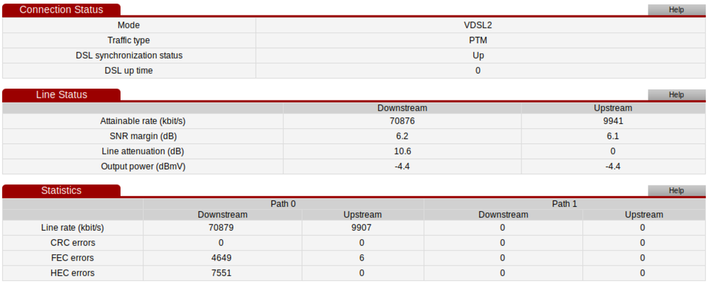

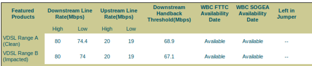

Anyone able to help shed some light on what may be causing my upload speed to be ~half of what it should/used to be?
When I first moved into the house, I used to get 17-18Mbps upload speed but for the past month or so,  it seems to have halved. I've got an unlocked HG612 modem and pulled the following stats. From my limited knowledge, the SNRM and attenuation seem pretty good. But do have interleave depth of 125 and INP 2.5.
Quiet line check seems OK, but only got cordless phones. Additionally the house doesn't seem to have a master socket, just all blank single faceplates. House was built in 2012 and guess it's been self installs since. I do have a filter in line. Don't notice any drop outs and modem is continuously on etc.

Downstream     Upstream
Line attenuation (dB):   10.6     0.0
Signal attenuation (dB):Not available on VDSL2
Connection speed (kbps): 70879     9907
SNR margin (dB):         6.2      6.1
Power (dBm):             -4.4       -4.4
Interleave depth:       1       125
INP:                     0         2.50
G.INP:                   Not enabled Not enabled
Vectoring status:       5 (VECT_UNCONFIGURED)

FYI seems to have been caused by an unfiltered phone plugged in upstairs. Need to order some more filters and keep an eye on it
