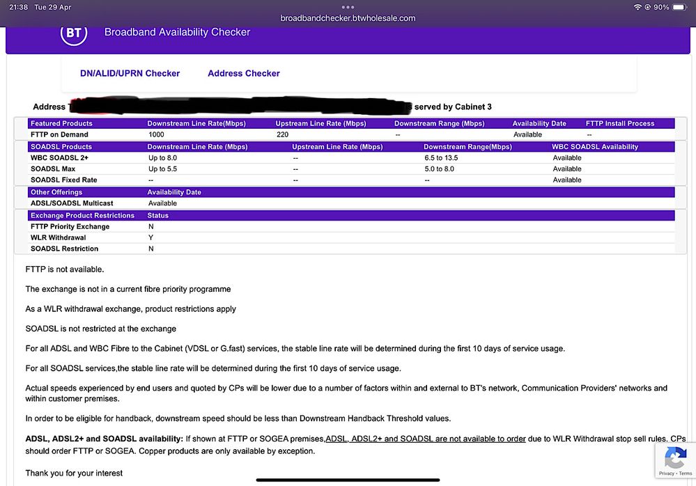

This is what one of the addresses says, the other one isn’t showing at all on the database so don’t understand why the BT adviser told them to get a landline installed at a cost of £70!

There is no FTTP available at that address, nor FTTC oddly.
