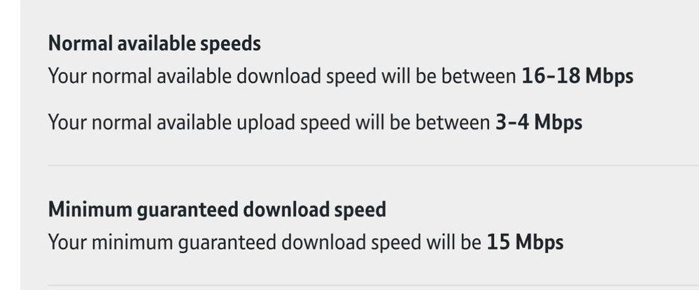

Just realised I have already posted about this back in June. “Upload saga”Still not resolved.
. D/L is fine at 22mps. But upload has been under 1 for some time. Thought it might be a glitch and improve by itself but this has not happened. Had an engineer about 2 months ago who told me as D/L was pretty good, BT don’t really care about upload speeds. So suck it up basically. it’s not a big problem for me personally but it is lower than specified in contract. Any thoughts?
2,220 Views
Message 18 of 23
Re: Upload speed
Go to solution
as was said in post in June you need to phone CS 03301234150 and request a DLM reset on your line which should clear it back to initial speed
