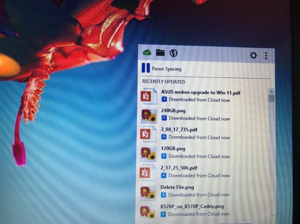

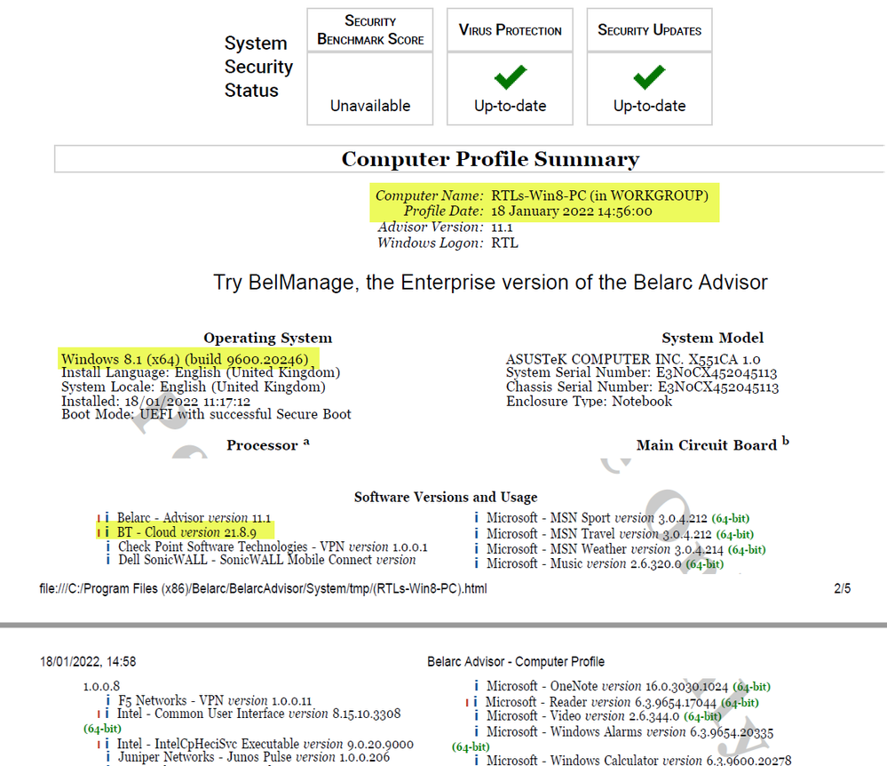

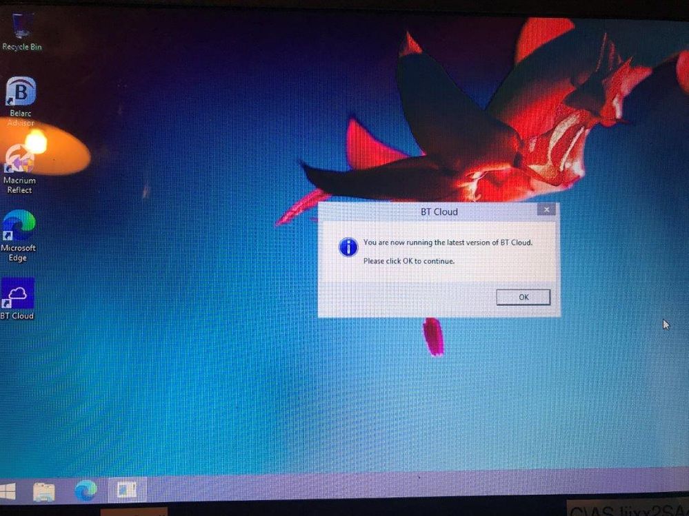

@str8chat  Hello.   I have this laptop that originally came with Windows 8 but I have been running Windows 10 on it.
So today, I downloaded the ISO for 8.1 and installed it. What a pain---it then needed 134 updates applied!!Anyway brought it up to date and have set Edge to be the browser same as yourself. Only other things I installed were Belarc Advisor and Macrium Reflect 8 Free so I could take images. That all worked fine.
I then installed BT Cloud 21.8.9 and it went on o.k.  I only use sync but the files  have all downloaded.
End result is 21.8.9 has no problem running on Windows 8.1 for me.
I've only got Windows Defender on. Maybe you have some other antivirus that could be interfering with the install. I would try disabling it---if applicable.
Extracts from Belarc ReportExtracts from Belarc ReportBT Cloud 21.8.9BT Cloud 21.8.9SyncingSyncing
