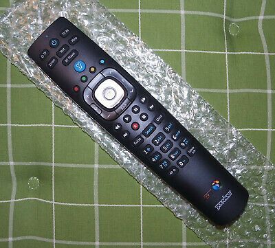

@dephead2004
Sounds like another case of mistaken identity. I'd guest that the TV is being turned on by CEC over HDMI, but has the wrong code set for IR control of volume.
One of these from Ebay should do the job:
