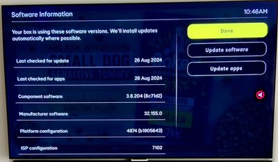

Unless you have a different sort of DTR-T2110 from me (!) you will be looking at this display taken from my T2110:-
Note that it doesn’t say Updated, just Checked. Also note that this changes day to day, and there is not an update every day!

@Dahla04  said above “myself and a friend have just had this happen to our boxes”, meaning a loss of recording ability based on a supposed update.
But I believe the observation that the boxes had updated was based on a misunderstanding of the relevant information, as per my screenshot above.
Certainly, my T2110 hasn’t failed, and I don’t think it has updated, though EE don’t publish this information like YouView used to, which was the only way to really know.

Thank you to everyone who have replied, advice and comments given, very much appreciated. I wrongly assumed that where it said last checked for updates/apps, it meant it had updated. I have spent most of the afternoon on this, trying to access maintenance option (they could make that easier), 4th attempt I finally succeeded. Took 25mins, did not work, still could not record. So watched one programme that I had recorded then had to do a factory reset, losing all the others. Another 25mins taken.
