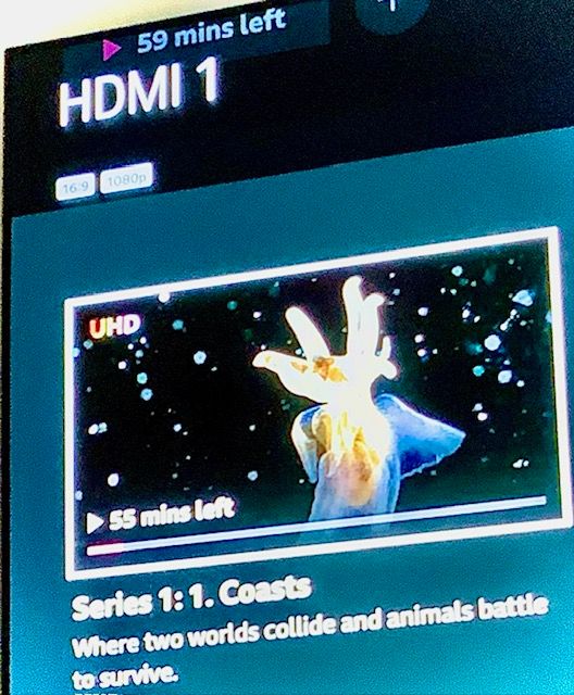

Just to say that I found out how to see what my LG TVs think they are being presented with (press the … button on the remote, select Information from the drop-down menu, and it appears in an overlay on the screen) and this confirms that for a DTR-T4000 at least, opening the BBC iPlayer in UHD and then dropping to 1080p on the YouView box has no effect on what the iPlayer offers you, but does make the TV see only 1080p. So the YouView box is not ignoring the drop to 1080p.
I can’t, of course, answer for what the Pro box does, nor for what special arrangement BT might have made for the THT Sport channels.
Sorry for the dreadful quality of the image, but the Community is holding me down to 333k.
Enough to show a UHD programme still being offered when the output resolution is 1080p, anyway.
