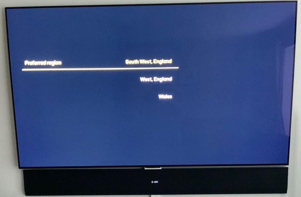

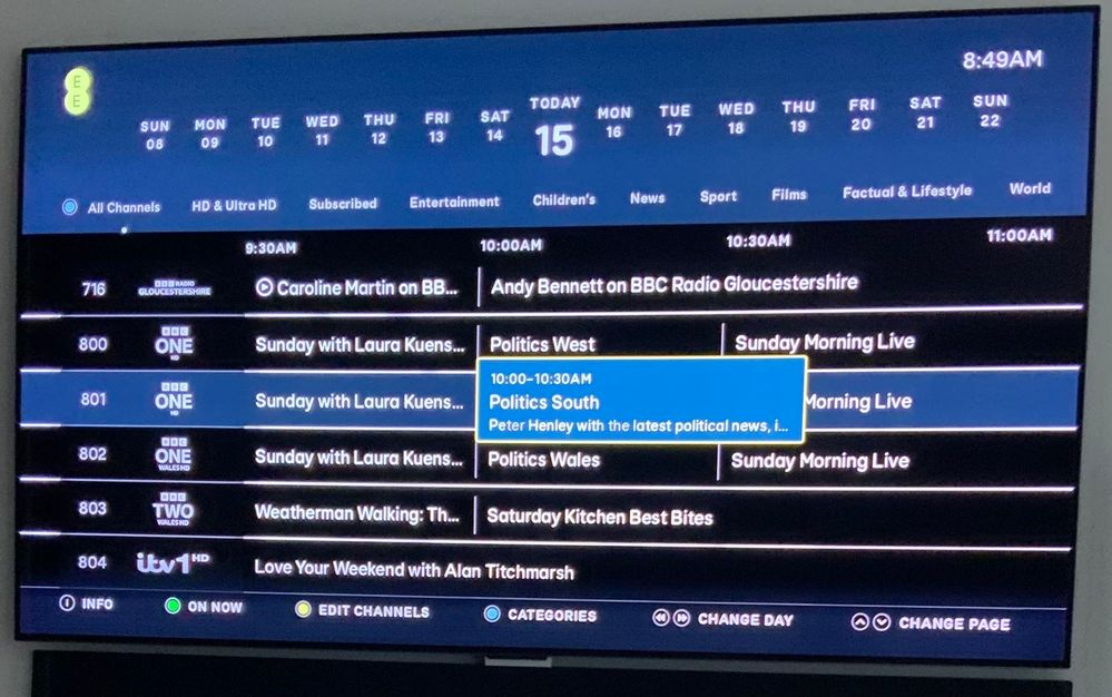

Yes, I was indeed offered four regions, in the case of the BBC, one on 1 and the other 3 on 800 - 802 as here, local programme chosen to show which is which, itv same difference, so your logs are quite correct:-
However, the YouView selection screen only offered me three of them, as here:-
Exactly missing out the one we wanted, now on 801 as above.

I have to ask, just in case - have you tried pressing up when on the region selection screen?

You do, quite right, good thought, and no I hadn’t tried it, but up doesn’t go anywhere 😢
All you can press on that screen as shown, the one you get navigating to the choices and pressing OK, is arrow down, to bring the two lower options up through the focus; then you can press arrow up, but it goes back to South West, England, and won’t go above it.

But I can now confirm that the Box Pro does exactly the same thing, probably to no one’s surprise.
Even down to what happens in the EPG at 800 - 802.
