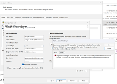

I am receiving the below errors :
Yes this is a Premium Account which is configured correctly but it still refuses to sync and repeatedly prompts for  a password which I already confirmed is correct by logging into the webmail app.
Please advise further.

I think the email address is case sensitive and your logon is showing a capital 'L' instead of lowercase
