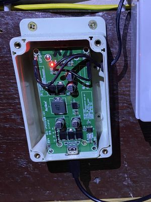

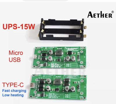

I’ve been using these USB-C Aether UPS modules for a while now on some Arduino projects and they have given good results - with 2 x 18650 batteries they last for weeks but the smart hub obviously pulls a lot more current and it’s close to the limit. The units have two LEDs,  one to show battery output is on, the other bicolour status LED. red = batteries charging, green = batteries charged, no LED = over capacity. With the SH2 (and
with a WD HDD spinning) the status light flickers on off so I suspect it’s right on the edge. I’ll look for something a bit more suitable.
