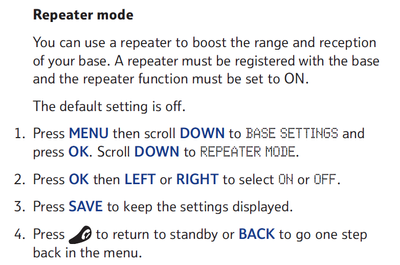

When BT first started selling DECT phones under the Diverse name around the mid-nineties, they were simply rebadged Siemens products. The repeater you have linked to is almost certainly also a Siemens product from around that time. These products had a specific setting in the base to pair a repeater.
When BT ceased this arrangement with Siemens, as well as a huge drop in product quality, the repeater function was also dropped. Here are the pairing instruction from a Diverse 6210 I used to have:
You will not find those instructions for your 8600, which is why I specifically referenced current BT handsets.
