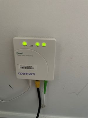

No Cover was fitted on my ONT.
Mine is not well fitted  - very wobbly on the wall!
It looks like the one above - but that is not actually mine.
Like the one above, there is a sticker on the front with a S/N number.  Do I need to take the front off? Please advise?
Thanks - think I might finally be getting somewhere near fixing the fault I have had for months now - since installation - 🙂
