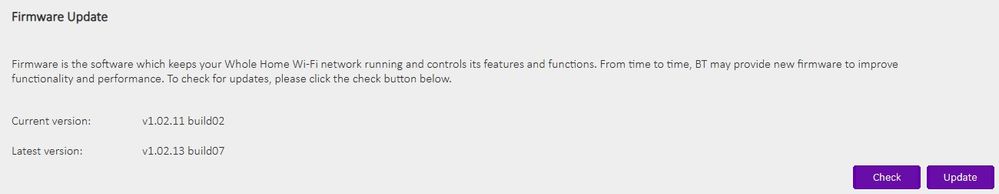

I have been on firmware v1.02.11 build02 for years. It has seemed stable for a long time.
The admin. console of the BT Whole Home system says the latest version is v1.02.13 build07. From a quick nose in this forum I'm not convinced that is actually the latest version, but maybe it's the latest my discs could go to in a single update?

The latest firmware version for your WHW discs is v1.02.13build14 which you should be able to install either by using the BT WHW app or by using the web GUI for the WHW discs.

Yes, I thought the same, but the web UI is clearly showing a lesser version. Maybe it would need to go there as a stepping-stone or something?

Yes you are correct, as your discs are currently on v1.02.11 build02 you will need to upgrade them to v1.02.13 build07 in order to then upgrade them to build 14, the current version.

v1.02.13 build07 is the build that is currently available to you from the build that you are on.  If you update to that version you will then be able to update to build 14 from build 07, but you are unable to upgrade directly from your current version to build 14, as you suspected previously.
