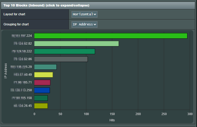

On the other side of things, this time yesterday I set up improved firewall reporting on my third-party router.  In around one day my router has been probed 900 times, and so far as I'm aware, nothing got through!

Addendum to my previous post!
A couple of hundred of those probes are from (low security) sites where in part I verify my identity using personal domain names and their associated IPs - not something many on here will be doing!  And yes it does mean there are a couple of vectors that if corrupted can prevent me from accessing those sites (until the corruption is fixed).
