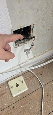

I have an old socket, which I believe is powering the master socket and leaving me unable to get rid of the cable...I think.
Old socket on the left of the picture. Newish master socket on the right!

The socket with your finger looks like it has the incoming external cable crimped to a internal cable feeding the other socket.
The simplest solution is to fit a new master socket at cable entry box and do away with the cable feeding the second socket if you no longer require it.

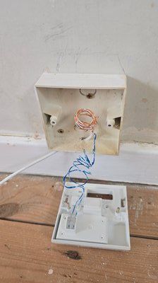

We're getting a media wall on the wall with the older socket with the wiring so we'd have taken that away but if he's the entry point I'll get a new plate for it and work it in!

If you are not using it, just remove it. It is the master socket, but it doesn't have to be  where it is at the moment unless that is where you want it.
Just put a new master socket at the box where the incoming cable enters.

The image with your finger in the shot is where the incoming external copper cable appears, it’s  cover is the original one that had  a hard wired corded phone  (old style rotary dial phone) , that’s why it has a square ‘hole’ in the centre , someone has connected an extension cable to the external cable to connect a modern style plug and socket phone , often the new socket is placed next to the original one with a very short cable between, obviously a previous occupant wanted the telephone on the opposite wall to the original cable entry point.
If that incoming copper pair is still required because FTTP isn’t available, then the external cable needs to be maintained , you could simply  shorten the extension cabling and fit the modern socket next to the original cable entry point if you don’t want that lose cable on the floor  , or look to somehow fix a modern faceplate to the original back box (connecting the external cable directly to the faceplate)
