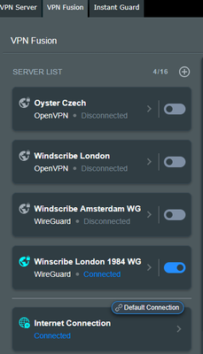

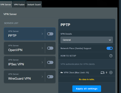

If you went with the stock firmware then VPN Fusion would be there as it is for me.
I'm guessing that if after you've reset & reloaded that you removed the VPN settings from the Merlin config and the updated the firmware to stock that you'd see VPN pages like mine.
And this Fusion page.
This is from my AX5400 but the AX82U looks exactly the same. If all you're using Merlin for is the VPN Client then the stock firmware is best.
Instant Guard is a simple VPN Server from Asus providing you have a public IP address - which I don't btw - and allows remote devices like an iPhone to connect to your home so handy when abroad & you need to do the Lottery or watch BBC iPlayer for example.

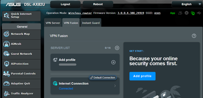

I have the DSL version of the AX82U & can confirm the VPN Fusion is present on that.
1,460 Views
Message 30 of 40
Re: FTTP with a 3rd party router - Speed Issues
Go to solution
@ripface
I'm using the latest ASUS release and it's there as my photos showed.
My RT-AX82U was a 2021 manufacture although that makes no difference. Checking the serial number suggests mine was manufactured August 2022 so a V1 version as the V2 came out Oct 2022.
Apparently VPN Fusion was added late 2021. What has happened in the past features introduced by Merlin etc do get incorporated in stock firmware and I guess this could have been an example of that.
