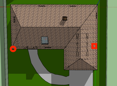

The incomer is the circle and the Firestick is the square.  The Firestick is half a floor above the groundfloor.  The groundfloor is a concrete slab so running a cable would mean taking it outside along a gutter an back in through a facia board.

@Navrig
Your pic isn't yet showing, maybe awaiting moderation. But you could try running ethernet to the middle of the L & relocate the router there, so it's more central. The router can be up to 100m from the ONT using Cat 5e cable or better. You could buy a long cable to test & then look at getting a cable nicely installed if it works.
