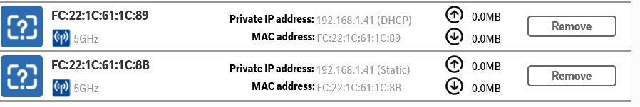

I did try a complete factory reset of the SH2, among other things, but unfortunately these wifi extenders seem to have an odd way of connecting.  They are dual band, so it seems they have two different MAC addresses for their two receivers, as well as two MAC addresses for their transmitters (if I can put it that way).  After negotiating with the DHCP server, they get two entries in the address table way.  Unfortunately, the two entries have the same IP address - as shown below:
The bizarre situation I have to deal with - two devices with the same IP address
as a result, I am unable to edit the details, because the code that handles the editing flags up that I'm trying to save two things to the same address, and refuses to accept the change.

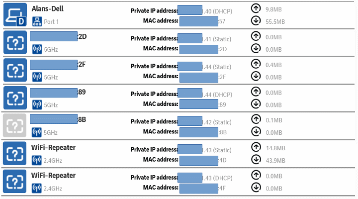

I left the DHCP pool range as [redacted].40 to .42 and added another extender.  The only existing allocation that remained the same was the laptop - the two entries for the new extender got the .41 address and those for the first extender got the .42 address.
Still leaving these entries untouched, I changed the DHCP pool range to [redacted].43 to .44, and then added another device.  And most of the existing addresses were changed, as shown below:
Allocated IP addresses after adding two more devicesAllocated IP addresses after adding two more devices
The strangest thing here is that the first two dual-band extenders have been given the same IP address for one of their entries, with MAC addresses ending 2f and 89.  And one of the entries for the first extender installed (with MAC address ending 8B) is shown as not connected, even though the other half of this extender is shown as connected.  Meanwhile, the third extender (listed as WiFi-Repeater has two entries, both for IP address 43, i.e. the same behaviour as seen initially for the other two extenders.
As the addresses (that I cannot alter) have been changed after my alteration in the pool range, I guess I'm just going to have to give up on trying to prevent conflicts, start again, and let the DHCP server do whatever it likes.
