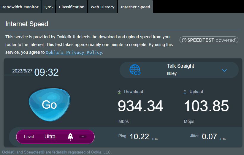

And I think we have a winner!
Turned QoS off, and ASUS speed test (built in suddenly showed 700 Mbps and 90 upload.
Speedtest itself showed in the 500’s.
I think that’s it solved!

Much of the time the only way to get a good reading of the speed from the ONT is to set up a connection on a PC, connect this straight to the ONT and then preform the test.  Even then the way the ethernet port is implemented on some PCs it can fall short of what's actually available on the line.
Some Asus routers can give a good representation of the speed using:
Adaptive QOS > Internet speed
but it does depend on the CPU on the router being capable enough to saturate the line (many many of those router CPUs are not)
