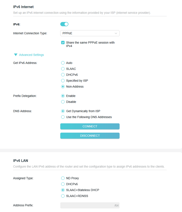

Out of curiosity I decided to try the Plusnet router in bridge mode and it works fine. However I have a problem, when I enable IPV6 on the Tp-link I get no internet. Does anyone know what settings I must use on the Tp-Link to get IPV6 working?

No luck. My internet simply stops working when I enable IPV6. Setting to "Non-address" which fixed it for the person in that thread hasn't fixed it for me. I've also tried SLAAC+RDNSS as suggested.
