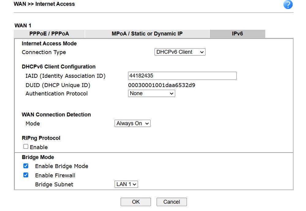

Yes, that reminds me, there is a bridge to LAN1 setting on the Draytek.  What's really nice is that there is also a tick box to make sure it still goes through the firewall as well.
Edit: Sorry, ambiguous there.  "goes through" as in enable firewall.
2,315 Views
Message 17 of 17
Re: ipv6 setup with a 3rd party router connected to BT FTTP , solved for TP-Link Deco X60
This is a picture from Draytek's interface demo rather than my actual router but it's set up like:
